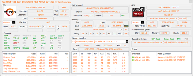

My PC:
Gigabyte x670 Aorus Elite AX
7950x3d
2x32gb G.Skill 6000 CL30-40-40-96
PBO C/O -30 on all CC0 cores except my two best cores which are set to -5. On CCD1 I have -20 on all cores except my two best which I have set to -5.

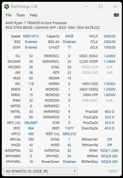

I notice that when I play FPS games such as valorant, or CSGO I am getting this very weird stutter randomly. I notice that if I turn off EXPO and run the RAM at regular stock speeds I dont get this stutter at all, the games run smooth as butter. But the minute I increase anything the stutter comes back. I've read some posts that comment about this kit being dual rank, and because of that IMC's are not able to handle it. However I used my best buy membership to my advantage and picked up a 7800x3d from the shelf, as well as a new motherboard and tried with the 7800x3d and the new motherboard wich was a asus b650e-f and the same thing would happen. I would get stutters the minute I increased anything on memory. At this point I'm at a loss.
Is the fact that this RAM is dual ranked mean that I am just going to have to run it at 4800hz, or am I just overlooking something very obvious. Any help and insight would be extremely appreciated.

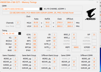

I posted a screen shot of my current timings as of no I'm trying out 5600mhz, but I've tried all the expo timings listed in HWinfo, all have produced the same results.
