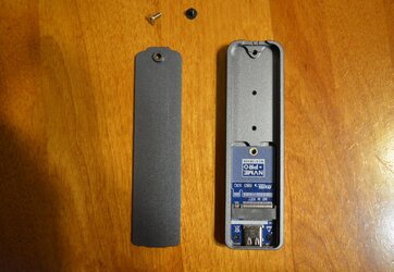

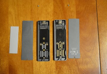

With the Unionsine and HIKSEMI enclosure's they are both the same with one small change to the board on the HIKSEMI in the upper right corner and it's a square shaped part and the enclosure's styling is a bit different.

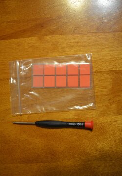

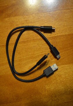

All 3 enclosure's come with extra screw's a screw driver wrist strap and thermal pads plus 2 usb cables a usb A to C and a C to C cable.

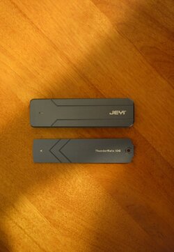

If I had to choose a winner between all 3 of these enclosure's I would choose the JEYI because the aluminum back panel is thicker and the walls of the enclosure's is also thicker over the Unionsine and HIKSEMI enclosure's.
The back panels on the Unionsine and HIKESMI are 1.20mm and the wall thickness of the enclosure is also 1.25mm,the JEYI's back panel is 1.91mm thick and the wall thickness is 3mm.
The Unionsine and HIKSEMI enclosure's are 106mm L 31mm W 10mm D,the JEYI is 103 L 28mm W 10.5 D
The other thing I like better about the JEYI is that it use's a back panel that has a tab and you set it on and slide it ahead a bit and then put the screw in and I found the thermal pads made better contact with the back panel plus with the back panel,I know with Unionsine and HIKSEMI they come with a slide on back panel or a set on one with a tab that's slid ahead and I don't know which is the new standard,also the screw is bigger that holds the JEYI's back panel on.

I didn't have the packaging anymore and the screw driver and red thermal pad's came with the JEYI enclosure and all 3 enclosure's come with exactly the same cables.
Incase anyone wants longer cables I use these cables and they have never given me an once of trouble and they are braided.
