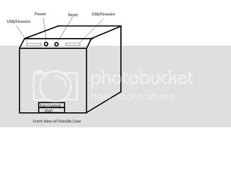

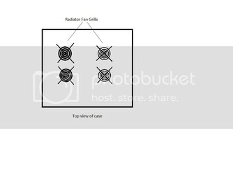

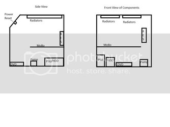

GMdoubleG had some specifics.
Looking for more of a cube shape. Horizontal motherboard. Two 2x120mm radiators up top.
Plan was to leave the aluminum bars and steel corner bracket unfinished--he would have a local painter powdercoat and/or anodize.
Going with all gray plastic paneling.
He passed along some general design drawings:
