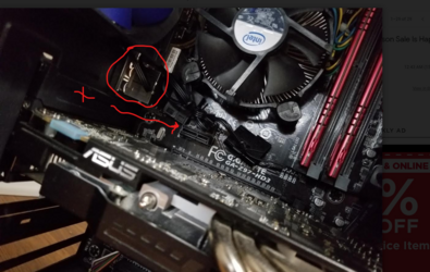

Here's a pic of an ATX board I have in a mid tower ATX case. Note the "short" slot is above the first PCI-e long slot and adjacent to the audio output jacks in close proximity. There is indeed, at least in this situation, an expansion slot in the rear panel that aligns with it. It is currently not in use and the cover is still in place. Not much room there to the video card, however, so any ad on card going in that short slot could not be very thick.

Bill, my post doesn't contradict what you said. Notice that I said, "at least in this situation." Yes, I agree with you. It may not be so in every ATX case but in a lot of them I think that high short slot has exterior access.
