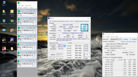

#1 My ambient room temperature is usually 24c maintained and may vary .5 either way, but ambient room temperature is really irrelevant when you are using a negative DeltaT cooling, meaning 14c below ambient. Ambient does have an effect when it comes to condensation on the outside of the CPU cooling water block, but at a 10c coolant temperature there has been no condensation to be concerned with at all. I do not run motherboard moisture insulation and never have, I operate in a below ambient window, meaning below ambient, but above condensation forming temperatures. That said using traditional ambient calculations to measure efficiency of chilled water cooling is kinda a joke isn't it. Seeing as how it is an active cooling system wouldn't the amount of electrical power being used vs results be a better conclusion to rate a chilled water cooling solution. You must also calculate in the unknown variable, which is the 3rd TEC assembly controlled by the thermal controller that controls the 10c coolant window, meaning the 3rd TEC is not powered all the time, only when needed. That 10c coolant window is cut in at 11c cut out at 9.9c to maintain a 10c operational window. Which is cut in power at 11.0c, active temperature drop, 10.9, 10.8, 10.7, 10.6, 10.5, 10.4, 10.3, 10.2 10.1, 10.0, 9.9c cut out power, which is the 10c operational window and the missing information is the time variable from cut in and cut out. So there are more factors to calculate into the equation besides ambient room temperature.
You can get #2 and #3 from the screenshot below, I'm experimenting right now at a 5ghz 8700K overclock running with HT disabled and all 6 cores overclocked, using the least amount of processor voltage possible, which is BIOS set to 1.250v. This is over 30 minutes of Prime95 and Core Temp readings and CPU-Z. Hope this helps! SS
The screenshot was taken at the maximum electrical and wattage load.
