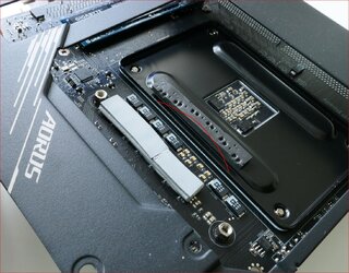

I wanted to add a warning about the Gigabyte motherboard. When I removed the vrm heatsink from the motherboard, not only did I had to reapply the thermal pad on top, removing the backplate exposed the existing theral pad at the back. Clearly that thermal pad at the back was not applied properly.
The issue then was that, Gigabyte's application of the thicker thermal pad that was applied at the back over some transistors/capacitors or whatever, that strip of thermal pad was curved so it did not cover all the parts. The photo below sort of indicate how bent that thermal pad was. In the photo below I had mistaken added a third layer of thermal pad, which is too much as the backplate is shaped, such that only two layers is required to replace the old thick thermal pad.
Maybe this thermal pad at the back isn't a big deal, but it certainly looked wrong when the pad did not really cover all the parts as it should.
Now that I look at the photo again, I do realize that the pad DID cover all the parts, but it sort of looked wrong.
The black thermal pad there which was removed has here been straightend out, it was applied cuved previously, I just placed it next to the new pad for the photo.

Some other brands have that little problem with pads too. It's not always but sometimes happens. However, as I remember it always covers what's the most important. It's just weird when it's not applied properly.
On one of my Gigabyte mobos, there was a pad missing and it was crucial because, under the pressure, the backplate was touching the back of the power connector, causing a short and the motherboard was turning off. It was random and at first, I didn't know what was happening.
