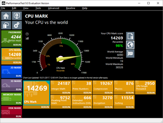

here's some more data and benches about the rig.
max power consumption while running P95 was about 470W (IPMI reading)
heres PassMark and Cinebench R15 Scores:
Here's my gaming rig in my sig for comparison
