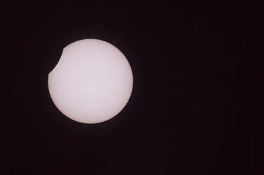

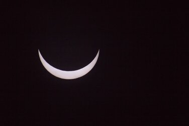

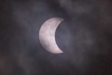

Note if you use the film, you're unlikely to see much surface detail. Maybe sunspots if there are any present. Below are some examples I took during a partial eclipse in 2015 by this method. There was some thin cloud which actually makes it more interesting. There's nothing visible on the surface other than one sunspot.
10003575_722526807867050_6499516890901410471_o.jpg 10927171_722526754533722_7202717942677052067_o.jpg 11017036_722526851200379_2306790758295565367_o.jpg

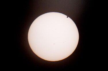

This next one is not of an eclipse, but is another example I took during the transit of Venus (the big black spot at the edge) in 2012. Again, some sunspots are visible but not really much else.

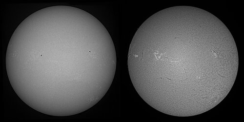

If you want more surface detail, it'll cost more and take more work too. Following images, on the right taken with a H-alpha filter, and on the left, a (relatively) cheap CaK filter.
In both cases I used a monochrome camera because the output of the filters is a narrow bandwidth at the extremes of visible light, so conventional colour cameras will have much worse effective resolution than normal. You can optionally false colour it, but looking at my attempts now, they're rather comical.
For the H-alpha image, I used the Coronado Personal Solar Telescope. This is a complete telescope for the purposes of viewing the sun. If you want to connect your existing camera you'll have to work out what adapters are needed to enable that. You might be able to replace the eyepiece, or use eyepiece projection.
For the CaK image I used what I think is an older version of this: https://www.baader-planetarium.com/en/solar/cak/calcium-gen-ii-125"-with-lpfc.html but again you're going to have to work out how to use it. The filter is not that big, so wont be suitable for many image paths.
I know I also bought an OIII filter but I don't seem to have any examples of using it that I can find. It could in theory enhance feature contrast for otherwise "white light" images but I guess I didn't have any luck with that.
