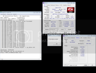

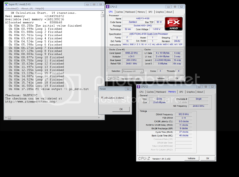

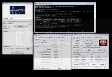

I just done a bit of super quick testing to get to the bottom of why the HT is set so high stock and i still dont 100% know, i took a few screens for you to have a look at and as you can see the higher HT hinders the memory benches (SuperPI) but it helps the CPU based benches (UCBench), i ran these test a few times and the results were almost the same each time.Once the cpu was clocked above 5GHZ the HT almost always needed to match the CPU/NB to finish a bench hence the 5ghz cap.Hope this helps the OP to make the cpu/nb match the ht for stabilitys sake.
High HT
Matched HT = Lower score
High HT
Matched HT = Higher score
