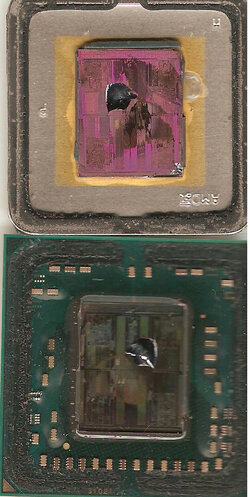

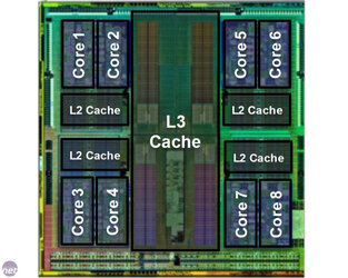

Firstly, I used two images from the web to get an approximation of a few things (images below).
The next image shows my findings which I will discuss.
OK, firstly, I wanted to know where the cores where in relation to the inlet of my Raystorm block.
As can be seen in the images, the inlet lays right in the middle of the CPU (which we can see is directly above the L3 cache).
So what I will be doing is to create a new inlet plate so that the water will first 'hit' cores 5/6/7 and 8 first, then move other the L3 cache and then finally over the other cores.
When pushing for maximum prime performance it is almost always core 5 and 8 that I have issues with so will find out if my mod will make any sort of difference.

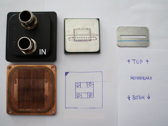

Anyhow, here is a pic of the inlet that my brother help me make.
Should be OK for testing, if there are positive results then will make a copper inlet.
The inlet is aluminium and I know metals shouldnt be mixed, but it wont be used long, just for this test.
Could you upload the images directly to the site?? Your links won't work for some peole. Just go to advanced post menu and use the paperclip.
Just a quick question here, are you trying for a laminer flow here and I would consider the size of the slot carefully since pressure could come into play as well.
Nope not laminer flow.
Keeping (well attempting to) the size of the slot exactly the same, just its positioning is being changed.
Oh sorry, I was not aware of some people having issues with the images.
Will do so for future images
