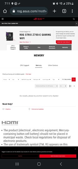

Well.... that memory isn't on the compatibility list for the board. While that's not absolute for saying it doesn't work, that doesn't bode well.

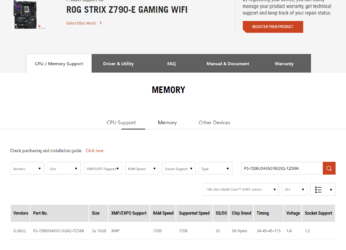

The ASUS website lists this kit as QVL for the Z790-E.
