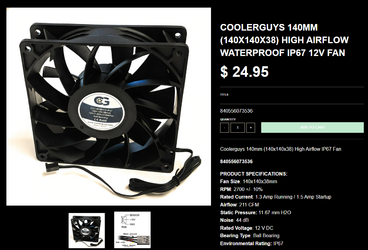

Ok, got my CoolerGuys fans in. Yeah.....I kinda knew this going in, but these are not for daily driving for a quiet rig. Benchmarking, sure.
They will start at 5V but have the reported motor surge. Once you get to 6V the RPM's ramp up and they run smooth. And boy do they move air even at 6V, and not quietly, either. They push enough air through my GTX280 to get that radiator easily to max performance. At 12V, they're just mad fans!

I gotta say, that fan you tested really has poor undervolting capabilities compared to all the Deltas I'm messing with. And for the size and power, I tend to believe a Delta could easily be undervolted to a nice soothing, non-harsh sound. Even the 80x38mm screamer rated for 0.87A is pretty good for undervolting. I'm convinced if its bearings were in better condition it would be much better than it is.
EDIT: I should note, I bought it USED (probably quite heavily) from an member of this forum 14 years ago and had it in service as a front intake for my Opteron 165 system HDD cage for nearly 10 years, 24/7ish. Stopped using it with my 2017 i7 7700k build. Now I'm using it again for 2022 i7 12700k build ^_^
Very similar specs actually when you consider the size difference. In fact the CFM is about identical when factoring in total unit volume. Similar noise etc. But the Coolerguys one is waterproof!??!?!?! 2022-03-18_231519.png 2022-03-18_231637.png
Supposedly it is, but I'm not going to test its water resistance.
It wouldn't surprise me if the CoolerGuys fan is the same as the GDSTime or Wathai fans.
