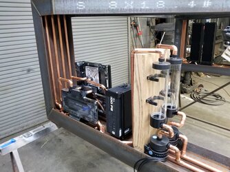

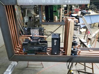

600lbs Steel I-Beam Desk/Computer Build
Yes I am planning on that. I did it on the radiator side as well. I am putting the loop together first then deciding where to place the unions.
The only issue that I see is the placement of the flow meters. It looks to me like you'll have to get on the floor and crane your head around to read them. Otherwise.... This is awesome.

I should be able to see them okay. Even so I'm not going to look at them all the time lol.

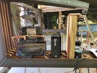

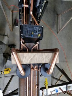

UPDATE:

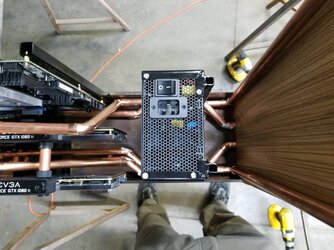

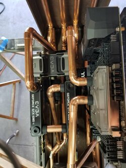

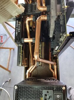

The piping layout is complete! Whoo hoo Now I need to solder it all.
In the process of laying out all the pipe work I realized I have no way of removing the PSU with the pipes laid out. I can't lower the PSU enough to get it under the bracket that holds it on. To fix this I'll be making it a quick-release style mount which will allow me to lift the entire PSU and mount straight up. I'm going to use pins to secure it in place. I'll also set it up to have a "service position" for cabling. This should make my life a lot easier during the cabling process. 202efb3b9a27ac7e542863c21666ecaa.jpg bef4edec1d9e8aa88f4d27518fab6fb7.jpg 1571afb61ed85db86ea99df3e1b1bd91.jpg 30c6e58d66fc6b8c8e9b8c5d62a7b6a2.jpg 9808309b78f21b100f630c4912a32d6c.jpg c04ccab3ec0d08189f2e77a2f1a9ebd9.jpg ed39933f54bddc8e04ce2ea0c4530a1f.jpg
