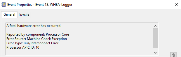

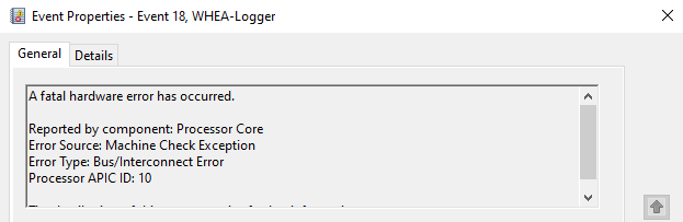

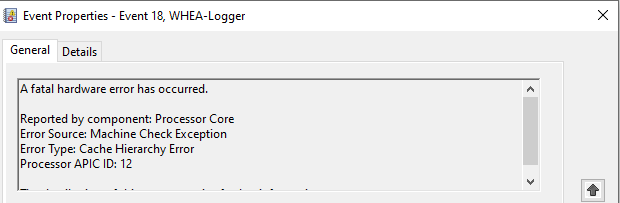

I got some WHEA Logger tho... these are CPU specific I believe...... so it may be my Ryzen responsible for all the crashes....

What was the crash code for the app when it happened? I'm not entirely certain what I'm seeing above and if it relates to that time and what happened... sorry.

Today I got a reboot while Playing Apex, it was like 3 days crash free but it did happen again. So I think it is cpu related. I don't know what else to try, should I disable CPB to run at 3,6ghz and check if it will not crash anymore? or should I try to give it more voltage?
This latest reboot gets this error:
