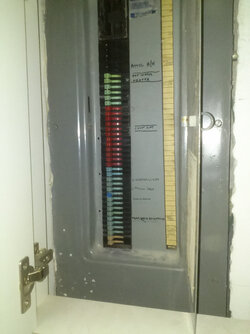

But BPL will only work if the satellite unit(s) and the base unit are on the same circuit. If the outlets in your apartment are not all behind the same breaker box it won't work. Does your apartment have it's own breaker box?
Do you mean this thing?

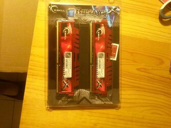

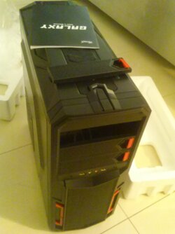

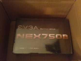

Update on Items that came:

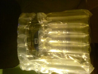

Do HDD come just in plastic bags not in boxes? I just want to make sure that this WD Blue drive is not a refurbished item.
I think that the whole house is powered via the breaker box on the picture above.
