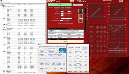

I try offset mode. With +0.50 got bsod after 6-7minutes. With +0.75, Additional voltage +0.20, PPL Enabled and LLC Level 5 (5 is higher, 1 is lower, I will try with level1)
I got stable 4.4 with max temp of 82c. My voltage is ~ 1.34?

your voltage is jumping since you are enabled Intel energy efficiency and using offset mode .
You can disable them in bios and set voltage to fixed .
Which setting is Intel Energy efficiency, cause I disabled most of them. I think offset is better, cause when cpu is not under load it drops to 1v?
I got also 4.5GHz with same settings. Vcore i 1.35 max temps 82.
different intel c state (c1e) , intel speed step (EIST) , limit cpuid max , overspeed protection . i prefer to disable all those to make sure motherboard is not limiting processor power , also some time reducing vcore and switching frequency high and low cause instability .
start with fixed voltage once you got stable you can try to play with auto voltage/freq drop if you are not comfortable with fixed speed/voltage.
All of them are disabled, including lpt port, intel virtualization, c1, c6 any power saving future.
