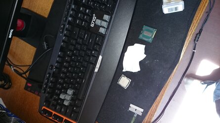

dont bother trying to delid your cpu with a exacto knife blade i tried this and its the reason it took me so long to re attempt it again. its too thick and will not work well to remove the lid easily.
If your going to do this use a super thin razor blade like a blade that goes in a single blade razor or what i used was one of those thin sharp replaceable scraper blades you can use for removing glue off a window or paint off glass.
after getting the right razor i had the lid off the cpu within basically 1 min.
it cut through the glue like a hot knife through butter.
then i took the blade and gently scraped / cut away the remaining glue off the edges of the spreader and cpu if your careful and don't push hard and stupidly i cant see anyone ruining a cpu doing this.
after everything was cleaned up i put some mx-2 on the die - put the IHS back on and clamped down the IHS in the socket with the latch mechanism.
Reinstalled the XSPC water block and fired up the pc.
Results are 25-30*C temp drops under load across the board depending on the Core.
I upped the OC on the chip from 4.6 to 4.8 Ghz and with this chip it took alot more voltage to do so and im still 5-10*C lower in temps @ 200Mhz higher clocks and a huge increase to voltage.
Its quite simply the largest difference in cooling i have had on my system it was even a larger difference in cooling then going from CM Hyper 212 Evo to Water Cooling XSPC Raystorm block with overkill amounts of rads and flow.
Highly recommend to anyone with a IVY or haswell cpu that may have heat issues or stability issues.
