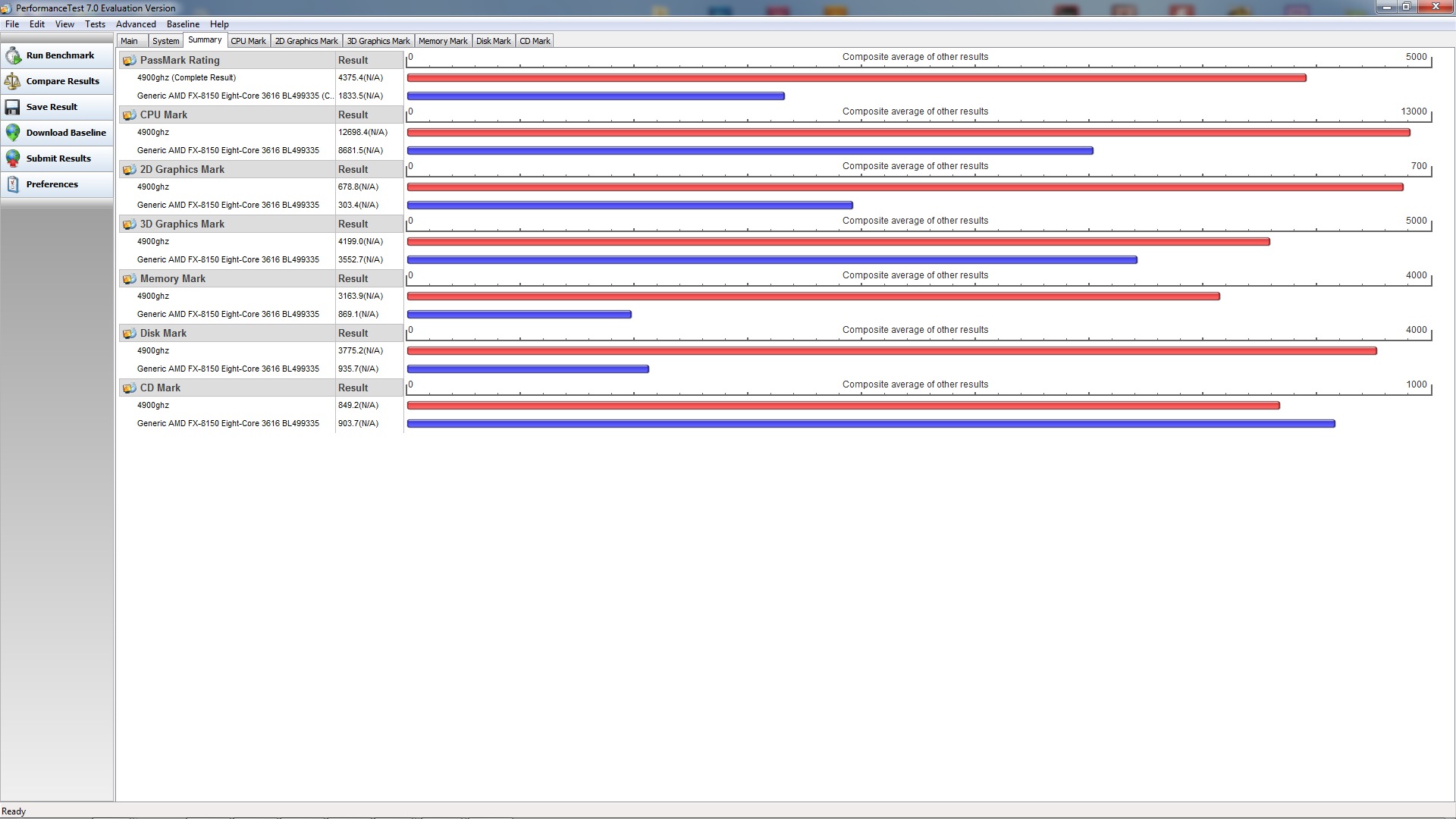

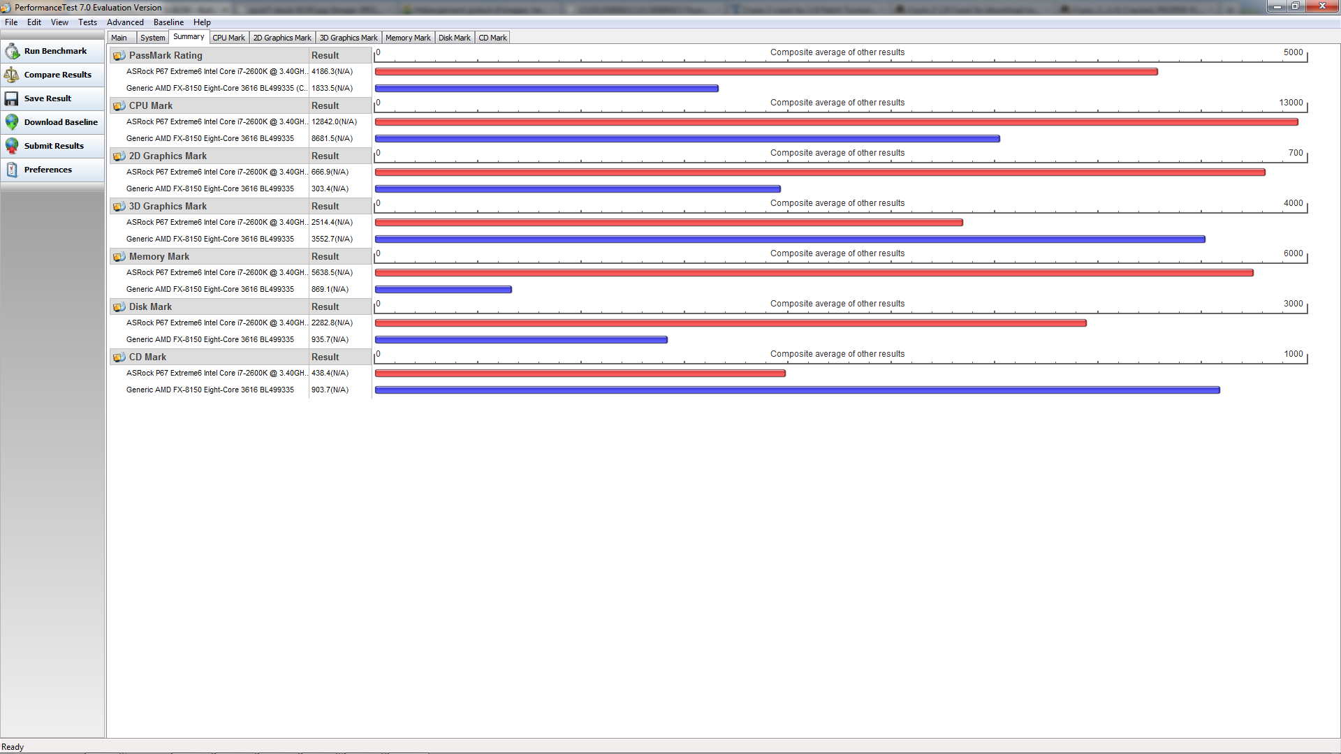

AIDA 64 Benchmarks
First up, we explore the AIDA 64 test suite. These tests were run only at stock to give a comparison of how the chips perform under various testing conditions.
AIDA 64 CPU Tests
AIDA 64 CPU Tests
Starting with the CPU tests, it seems AMD’s positioning this chip against the 2500K is accurate. The two chips trade blows throughout the CPU test suite.
AIDA 64 FPU Tests
AIDA 64 FPU Tests
Floating point performance isn’t looking so good. Not that it’s bad compared to the professed competition, but that they actually lost ground to the Thuban. I mentioned this might happen based on the sharing of FPU cores rather than duplicating the entire core, which would have given the chip a healthy boost with eight FPU cores instead of four. It seems those fears have been realized and the Thuban – with six FPU cores – out-performs Bulldozer. For better or worse, AMD has put all their performance eggs on the CPU side of their chip.
AIDA 64 Memory Tests
Memory is one area where Bulldozer does quite well for itself. They are within spitting distance of Sandy Bridge (which has a stellar memory controller) for reads and copies but lag behind a bit with writes. Still, AMD has gained significant ground over Thuban.

Is that your intel chip @ 4.9ghz or is that showing the performance increase of a BD @ 4.9ghz from stock?
manu2b's Avatar
Lol, that's my rig vs 8150 stock
EDIT: try to find some 8150@4.9, back in a minute
EDIT 2: that's the only one I found. Going to put a screen with a stock 2600k
SuperTuner12010's Avatar
Thats what i was trying to figure out...Wasnt sure what I was looking at.

Re: re-running benchmarks clarification - I didn't retest everything on the 2600K IMOG; so it's not re-tested for every review. Only when there are strongly relevant changes (like a service pack or something) would I do that. I am definitely a packrat though. The only things I've sold are a case and a GPU to fund the other things Archer is speaking about. Most recently that meant a Dewar for the Bulldozer review.

Sorry guys, when they set a price it is for OEMs and the price was per thousand. Here's a ss of intel and amd prices, notice 1k tray prices. That's 1000 pieces. Why jump on me when you can see for yourself. I've been in this a long time. Put in over 500 cpus myself. Like a megabyte and a million kinda thing.
100644 100645
