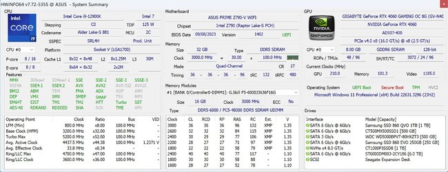

PS: it's normal your GPU turn on x8 ? To many disk or something ?

.... if it was an x16 card. IIRC, its 4.0 x8 so.... seems right. :)
4.0 x16 or 5.0 x16 won't yield improvements. Think of it like expanding the pipe/bandwidth but the water/data flow in it remains the same. 4060/4060ti can't saturate 4.0 x8 so making the pipe bigger doesn't matter.
Edit: even with a 4090, the difference between 4.0 x16 and 3.0 x16 (same as 4.0 x8) is only ~2% at 4K. 😉

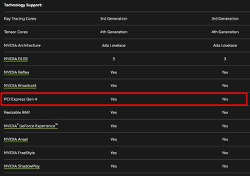

It doesn't list PCIe though. One part is easy: all current gen GPUs are 4.0 only from red, green or blue. No one outside of one Chinese company does 5.0 yet. Lower tier GPUs have fewer lanes now but you'll have to check on a case by case basis.

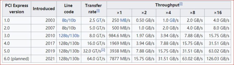

Then there's the theoretical maximum speed, which is indicated by the PCI express "version", from 1.0 to 5.0 (today).
Example: I have a PCIe 4.0 x16 card in a PCIe 3.0 slot x16, no problem.
And to come back to the original question, there's not much difference, because it's rare to use so much data.
In your current case: 15.75 GB/s, like me in PCIe 3.0 x16 ;)
