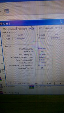

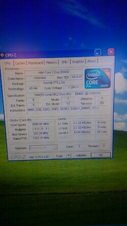

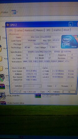

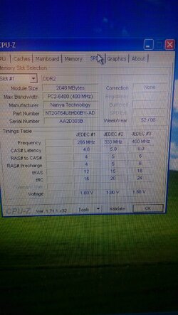

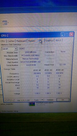

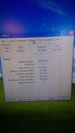

Show us pics of CPU-z tabs: CPU, Memory and SPD.
trent do you want pics of the cpuz from the stock cpu settings or pics of what the settings are when i overclock?
Goodness gracious... screencaps? Is this 1998? As an FYI, in order to capture only the active (front) window, hit alt+prtscn. Paste into paint, save, then attach to the forums. If you want to get the whole sceen, hit prtscn, paste in paint, save, and attach.
1. I find it hard to believe you need 1.35V for 500 Mhz overclock, especially considering your stock voltage is 1.26V...
1a. I'll ask again, are you changing the voltage manually or leaving it on auto? Your bios SS show auto...you should be doing it manually.
2. Your ram is overclocked now as you should be able to tell (look at memory tab and see the speed of 468 mhz). Lower that down in the bios.. system memory multiplier. It should lower to a 1:1 ratio with your FSB. So if your FSB is 390, your memory is running 390 and underclocked. You want to take the memory out of the equation.
You really, really need to wrap your head around the basics of the guide. This stuff is all in there... :)
Kaitlin4599, if you are having a stability problem the most obvious culprit, as ED already mentioned, is your RAM frequency running too high. Your RAM is rated for 800 mhz and the pics show that your overclock carried it to 936 mhz. Realize, first that CPU-z will show the DDR bus speed of the RAM which is half of the DDR2 actual frequency. So multiply that number by two. 468x2=936.
But I think the big idea you haven't grasped is that when you overclock using the FSB the frequency of the CPU is not the only frequency that rises. The FSB is the master frequency of your system and there are several frequencies that rise in concert with it. Namely, the CPU, the NB (aka, CPU/NB which is the memory controller) and the memory bus. If any of them get too high or get starved for voltage then instability can result.
So, to remedy the memory frequency issue you need to change the memory divider, which is essentially means starting the memory at a lower speed in bios than it is rated for. So try starting it at 266 (DDR2 533) or 333 (DDR2 666) instead of 400 (DDR2 800).
